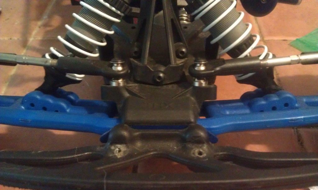

    hey guys i have a little question, my jato keeps turning right and i cannot see why, i have tried steering trim but it didn't work out, this happened when i installed the aluminum turnbuckles (part 5539x), could you
    guys help me, hear are 2 pic to show you how my front wheels are pointing (btw my steering trim is on
    the middle).

    i have tried a different location for the turnbuckles and this is what the wheels look like now

    ok i managed to set the camber but not the toe so my question to you guys would be, what's your toe? so that i can set my wheels straight

    0 up front. Use this mounting position, and adjust the turnbuckle length. The manual has detaled explinations on how the mount positions effect the truck, important to read up on it.
    4 degrees rear, but rear is fixed to the anti squat arm mount.
    Once STD settings are set, use that as a starting point for suspention tuning.
