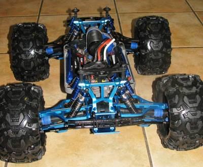

    Well Here is my EMBE. Do not profess to know it all, but have picked up a few things along the way which will hopefully prove to be useful to others out there.

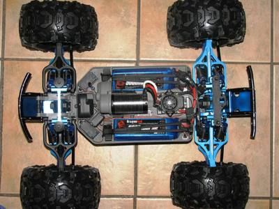

    First thing I did was tap into the power of 6s Lipo's. Word of advice, probably better if you don't jump straight in with 6s Lipo as I did as you end up spending a bit on broken bits.
    So,as most of us know, the stock EMaxx does have a few "issues" with durability. So after a few mild jumps and crashes (seriously nothing hectic) the repair bill was mounting up so I decided to go Aluminium crazy as you can see.
    Upgraded Shock Towers, Shocks, Upper & Lower Arms, Toe Links, Chassis Braces, Skid Plates (incl. Centre) and Bulkheads. After having run these for awhile and now with the benefit of hindsight I can say that not all was needed to be upgraded. If you are worried about adding too much weight to your truck or strapped for cash I would say that the Upper Arms can be kept plastic as well as Centre Skid Plate. I would still keep all else Aluminium for strength and rigidity (having the Chassis Braces, Bulkheads & Skid Plates Aluminium and connected together gives a very nice rigid underside of the truck and too date due to this I have had no need to upgrade the Chassis itself to Aluminium and have avoided all the pain (time & money) that goes with changing this out.

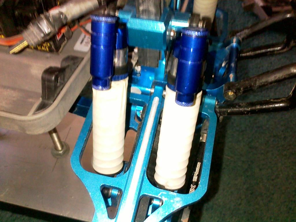

    And added Shock Boots (fingers from Latex Gloves). Have made a big difference in keeping shocks clean and working properly. Have to date not lost shock travel or movement and am racing on some seriously dusty track
