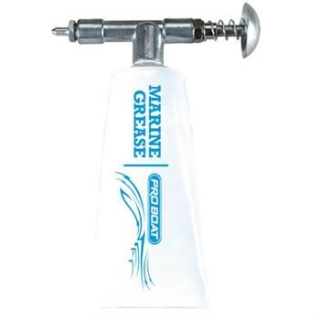

    This is the grease I use on the flex shafts for my rc boats. It does not soften up as easily as the grease that comes with a Spartan, it still augers it's way out but I just make sure to clean and regrease after each set of batteries.
    As stated above, with the collet loose from the flex shaft spin/turn the prop with your fingers and it should be free turning with no grabbing or catching. if you feel any binding at all, inspect your flex shaft closely.

    Thanks for the info orca44...got 2 of those coming my way!!!
