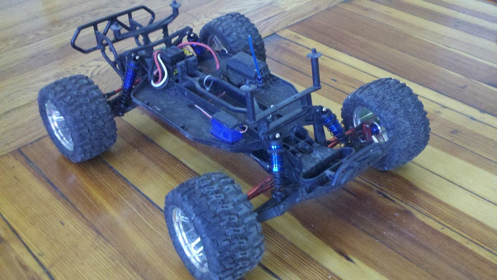

    This is all coming together nice! You say your a jumper.... me too! Here's the set up that gets it done for me,
    I tend to hit a jump over in over, it seems I cant tear myself away from an awesome jump!
    I learned alot on that particular jump lol, alloy shock caps for the losi's, needed bigger stronger links (thedreaded slayer links were used from then on), also found that the proline chassis saver is a must. I split many chassis in a few weeks but the saver put a stop to it. Also, you may want a alloy bulkhead. The screws will forever strip out of a stock bulk on a basher slash!
    Im anxious to see you lid finished, truck in full order, its gonna be a beauty! Im also interested in reading about your f/r bumpers, how they do with a basher. I love the old f/r skids and front bumper from proline.
    The pix above are from a few vids I made, also did a build thread on the truck, thedreadedend's slash mt xl.

    Quote Originally Posted by JDenham View Post
    Anymore pics of the wheels ? What size are they and brand ?
    These are some custom cut tires (2.8 trenchers) on a trimmed rim (3.2) ofna mt3 splits. Hers a thread on how I did it
    http://traxxas.com/forums/showthread...res-made-easy.
    I cut them to get a low profile/huge rim combo .....cut out the sidewalls, reduce roll and ballooning, increase performance.
    The combo's above are the same size as intended 2.8 tire/wheel sets but improved ability and look trick!
