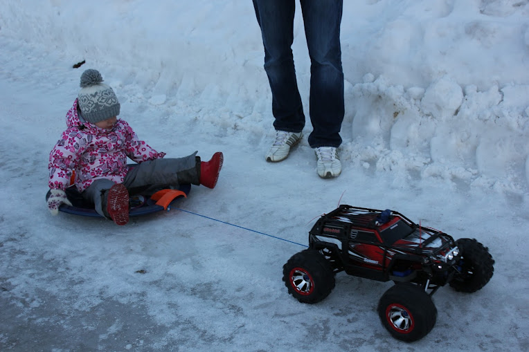

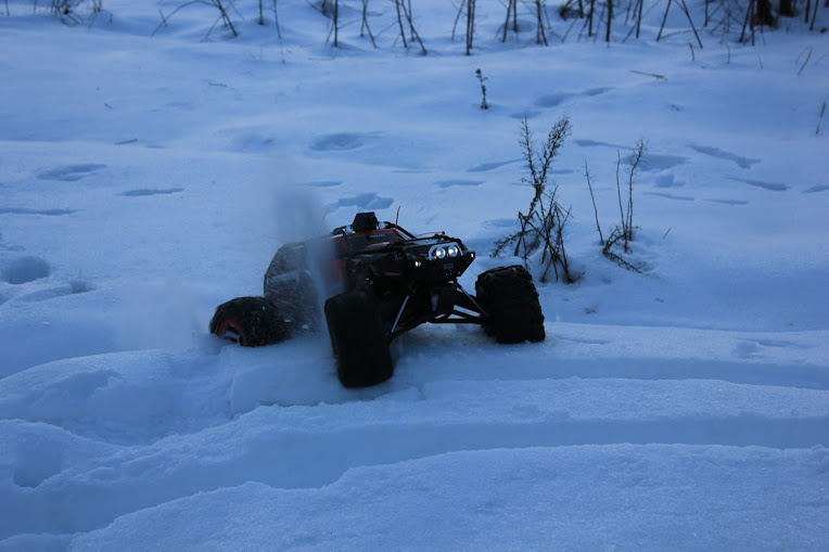

    Why 3.8V/cell is normal? At all of my another cars cut-off is normal at 3.2v/cell and my friends with different cars have cut-off at 3,2V/cell. Why VXL cut off at 3.2V/cell???
    I'm going in Russia:
    Photo https://plus.google.com/photos/10382...J2q6_X-haui2QE
    Video: http://www.youtube.com/watch?v=7RdHz...JuBAiQ&index=1

    How you were driving it?
    What was the weather like?
    Whatever it is I just said... I could be wrong.

    Im Driving in Russia. Drive in normal mode 50% high gear, 50% low gear. Weather now is snow about -5 -8 degrees by celsium.

    Lipo batts do not like the cold very much
    Do not like it at all really.so my guess is
    They are sagging enough to trigger the lvd under load.but rebound back up at rest.are these new batts or older packs?

    Are your other cars 15+ pounds before you added fpv gear and snow load.
    Again sorry for wasting MY time bothering to reply.

    "Are your other cars 15+ pounds before you added fpv gear and snow load."
    Don't understand. FPV have ownn 3S LiPol battery 1450mAh.
    Slash 4x4VXL have normal 3,2V/cell cut-off.
