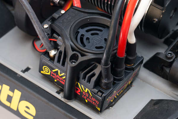

    I do not understand why it has 2 kind fan.
    One water proof and the other not ??????????

    the picture you've posted are the same, the one without the fan are for 1/10 scale and are rated for 3s while the one in the picture are for 1/8 scale rated for 6s.

    it is the same esc, just on the second pics it shows the esc with the mounting attached to the chassis of the car.
