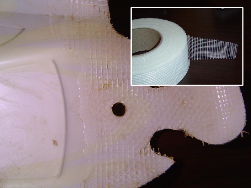

    I have a idea to run by everyone here. Fiberglass drywall joint tape self-adhesive fiberglass mesh is thin and light, but extremely strong and easy to use, and greatly increases joint strength and durability for less cracking when mudding and taping sheetwock walls. My plan is to put a layer of this stuff on the inside of the Lexan body to help make is stronger.

    Sorry to tell ya, It's not a new idea by any means, It's been done a million times for years now.
    But yes it helps strengthen the weak points of the body and can be used to fix spots that are cracked, etc.
    Shoo goo and fiber mesh drywall tape.

    ^^^^^ this is cool. I was just looking at roll of drywall tape I have laying around wondering If I could use it to repair one of the bodies I have that's cracked.

    SEE!!! I knew it was a good idea. Man, there hasn't been an original idea since 1942. SOoooo, shoo Goo. Probably better than fiberglass resin because it stays flexible, not hard like the resin?

    Yes by using the Shoo Goo, it will stay flexible after it drys. You wouldn't want to use a resin that hardens. And you wanna use the mesh tape only.
    I have repaired several bodies in the past using this method, It works great! The only slight downfall is it will start adding weight, especially some guys that will do the entire underbody.
    I was going to do the entire underbody for protection, apply as soon as it comes out of the box.

    I did three layers on a little crack on my 2 week old slash 4x4 body. I did not want that crack spreading at all! Prepped two body's for rocker guard paint today. Let them dry overnight last night.

    Just tried the shoo goo and drywall tape. It's just like doing a fiberglass repair. It seems like it should hold up pretty well.

    Yeah it does! I found it hard because my shoo goo dried so fast that it was hard to cut a piece of drywall tape and place it with sticky gloves on lol. Kindof a two person job!

    Hope the way I did it works. I just put the tape on then put a bead of shoo goo over it and worked it in with an acid brush.
    That's the way I plan on doing it too. The fiberglass tape has a lightweight adhesive. So, tape it on, and shoo goo to make it stay on.

    I covered the entire inside of my rally body with the Shoe-goo drywall method. Used 2 tube's of goo and 10' of tape. Added just over 10oz. to the weight. I doubled up the tape and goo over the post hole's, they need it the most.

    I couldn't find the scale to do a before weight but, the after weight of the Slash body is 366 grams with 4 washers. I fiberglassed a washer at each hole.

    no need for taller post's. I just make sure to do 2 layer's of tape over the hole's. The rest of the body has 3-5 layer's.

    No, not any harder to install, still has space for washer on outside... barely.
