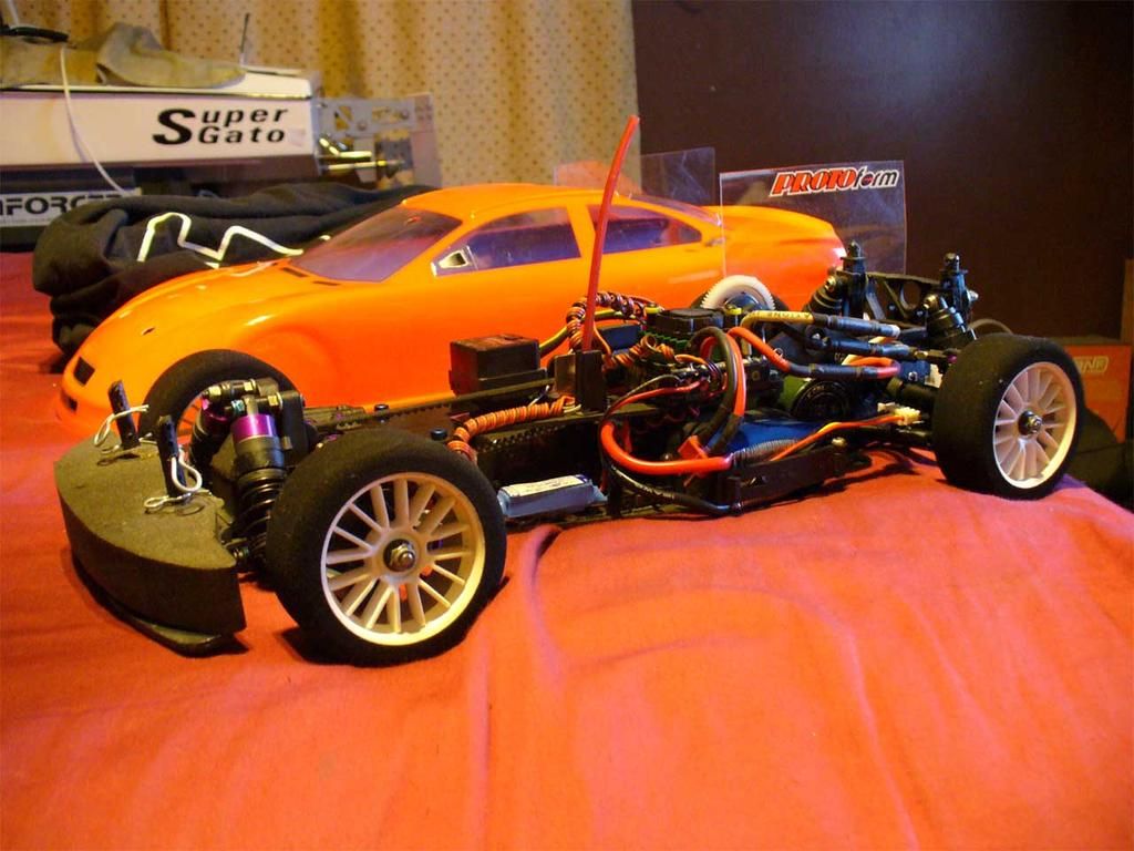

    I built this car a while ago...figured I would share it here...
    I began with a factory Traxxas 4-tec and added a few off the shelf mods to make the car a bit faster than the rest...
    ...after initial testing with a brushed setup(35mph) i quickly noticed i was opening Pandora's box and installing every part that came in it! Within a few days the new parts began finding their way onto the car and with each testing session the "little 4-tec that could" became more and more like "the little 4-tec that WOULD!" ...here's a basic rundown on the setup:
    CF chassis
    7700kv BL motor (Mamba - added Mar-23-2009)
    Mamba Max ESC(addded Mar-25-2009)
    3000mah 4s1p LiPo
    43p/75s gearing
    Futaba GY401 Gyro
    Futaba 3PM FASST radio
    Castle Creations 10A BEC
