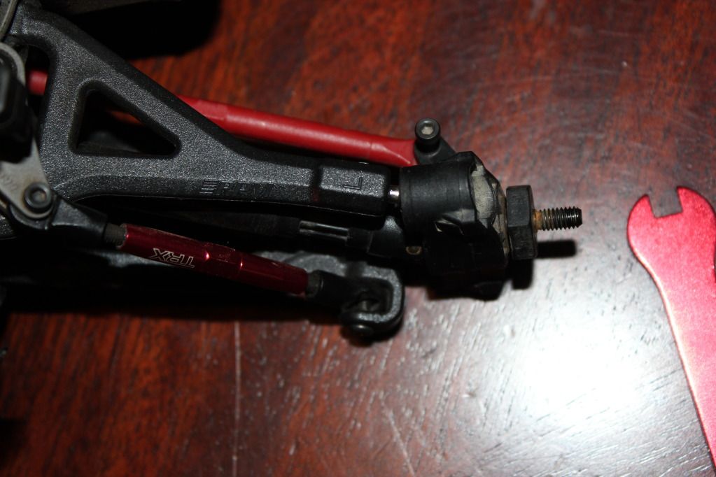

    my wheels wont turn strait in I don't know how to fix them.please help me.btw I just installed new rpm front a-arms and before they were fine.

    your pillow balls need adjusting!
    start over with the rpm instructions back the pillow balls out until you see the threads then screw them in per the instructions problem is at this setting rpm says don't tighten any further . only back them out .
    normally if your tires are pointing out like yours tighten top and bottom the same amount will give you toe in. look at page 22 or your manual

    yes back the shiny ball with threads out and start over

    its not working the instructions said front top 4 turns and the front button 5 turns
    and it wont push down unless you push really HARD
    and the wheels are not strait at all

    Your right pushrod bolt at the rocker is loose.
    Can't tell but the pillow balls might be in too far. Back them out and recheck

    On the front passenger(right) side try adjusting the bottom pillow balls in. It should make that wheel go inwards
    The front driver(left) side try adjust the lower pillow ball as well, turn clockwise(in) if there is room for the threads to go in
    If ur backing out the bottom back out the top a bit as well

    The other problem is once you turn the upper 4 turn and lower turns turning any further voids the warranty!

    Too bad you didn't get the traxxas adjustable toe links first before the push rods
    It'll will save you some trial n error with the pillow balls.
    It's well worth the upgrade.

    Looks like you have the wrong RPM arms, maybe they're for a slash or rally, too short. Second why are you using rally aluminum toe links as push rods? I'll put a pic up of my RPM arms in a min so you can see the difference.
    Edit can you take a pic looking straight down on the arms like my pic? In one of your pics they look too short and in the other they look ok.

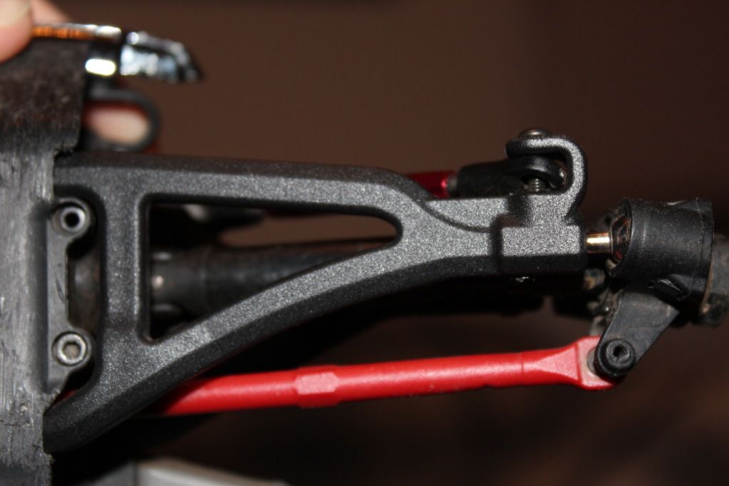

    here they are tell me if they are a bad pic
    top
    bottom
    and the reason why I have the toa links for push rods is because my dad got the wrong ones that are for the slash but I released that the toa link would work for a push rod.

    I stand corrected they're the right arms, but your pillow balls need to be tightened more (especially the bottom one). Don't be afraid to tighten them up some more. Tighten the top a couple turns then the bottom a couple turns till the wheel is straight. That's definitely the problem. Plus your aluminum pushrod is not in the right place, it's supposed to be connected to the steering and its definitely too short. It looks like that aluminum link is for a rally.
    See where my pillow balls are at? That's the sweet spot.

    I was still trying to install them.
    an update for how do they look??

    There ya go, looks good. You even have a bit more room to adjust if you need to. Good job getting it fixed!

    thanks!!I did it
