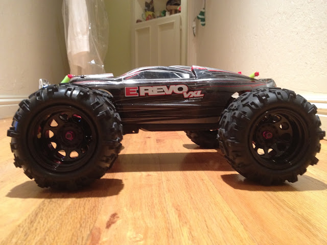

    Shortened the shocks and installed them. I also installed some led lights! Just waiting for the new servo in the mail.
    https://lh5.googleusercontent.com/-g...0/IMG_0719.jpg
    maybe I'm doing something wrong with the shocks because the stance is so much lower and there is barely any travel. I think I will eventually switch back to the traxxas gtr's with hr bodies

    Jimmie have you had a similar experience with the yeah racing shocks limiting travel? Like I said before
  28. #28

    If they do, it isn't enough for me to notice.

    Ok, but in the first picture doesn't the rear look much lower?

    Looks like when I put limiters in mine to lower it for speed runs
