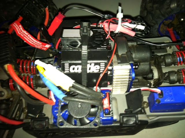

    I just got the castle blower (around the traxxas blue heatsink) and muchmore fan (on the esc) installed -
    all connected to the receiver BEC with the front and rear LED's from the big summit. I will post some
    pics tomorrow but I ran 2 packs through it and the motor was barely warm. Unfortunately I don't have a heat gun yet, but I will post temps when I borrow my buddy's. Keep in mind my little guy LOVES to run in the grass and even with the tranny flip and 14T pinion it didn't go into thermal, but both were quite warm (I realize this is a useless statement without the temps lol).
    I will say that I think the castle motor blower/cage with the traxxas heatsink is a great combination for a few bucks more than the Integy setup which seems to have its own issues.
    Farmer thanks for the detail about mounting your fan - I was going to fab a bracket, but obviously straight to the heatsink is the most efficient and easiest manner. I got the 30mm fan, 25mm would've been a better fit
    though I figured the higher CFM outweighed the better fit (and its only 5mm).
    Thanks
    Excuse my wiring - wil tidy it up tomorrow.

    Hi guys, just wanted to update - I (well, my son ) has over 50 runs on this fan setup and even in 90 degree plus weather through grass she runs great and the electronics stay around 120. THis is with the tranny flip and stock gearing (went back to 16), on both 2S lipo and stock NIMH packs.
