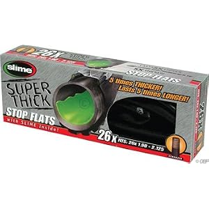

    Wow Deisel...that is quite a tire factory u got there...
    has anyone ever used those no puncture liquid foam on their tires?...
    i've never put together a wheel/tire set....and so i'm clueless...but reading up on all the trim and the duct taping and stuff...i was just wondering if anyone has ever tried to use these...

    Isn't that for bicycle tires? What would the slime do

    Thy slime stuff work on 1:1 tires when you have a slow leak. It makes a huge mess when it gets out of the tire.

    Quote Originally Posted by O.G. View Post
    i've never tried it...but i figure u gurus have probably thought of it and tried it...was just wondering...
    i'm just starting to get into this hobby...and so...i know nothing...and i'm proving it...

    It wouldn't really work that well. It needs to be in a sealed tube. It would be a TON of messing around to to get the tubes in and make sure they stay the right shape, and make sure there is a way to pump them up. The foam is more reliable, and FAR less effort haha.
