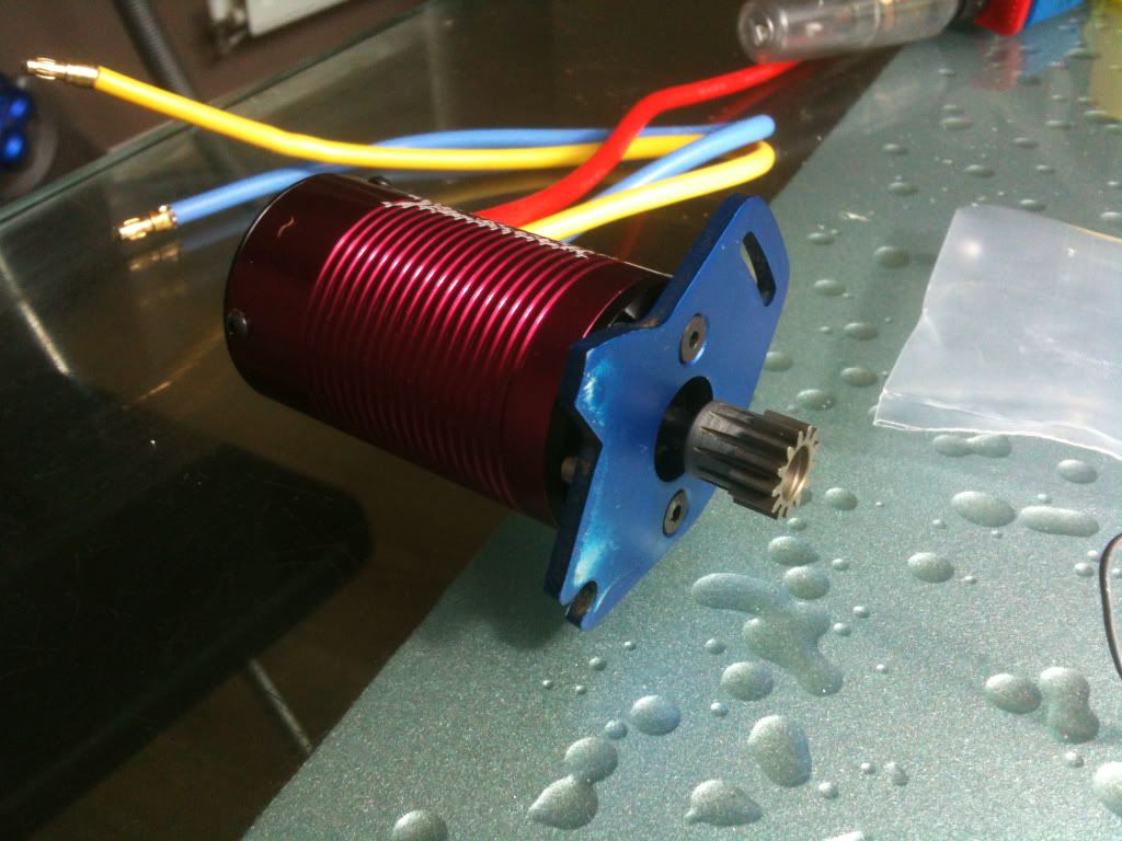

    Here it is:
    Love the English:
    But nicely packed, only took 1 week from china:
    Useful tip: place bullet in the hole of an old spur to hold when soldering - they don't melt and hold it nice and still:
    Old motor:
    New motor mounted:
    It's a tad longer:
    And....... Even with only 13/54 - it flies - this is the first time on 2s I've ever seen this truck wheelie! - ruined my mini spikes in 1/4 of a pack!
    I'll give it a real try out when the 14 & 15 tooth pinions arrive - its under geared at the moment (motor temp only got to 73F, esc 71F)
