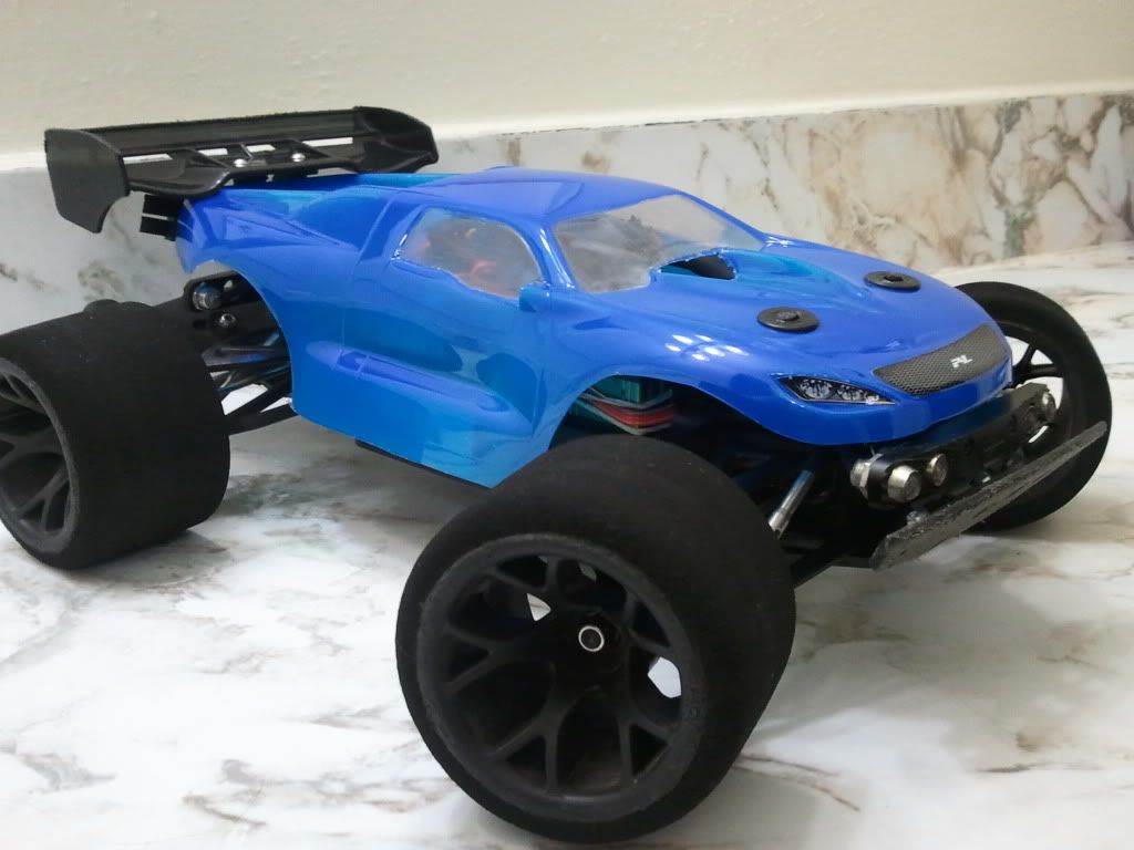

    For tires, use Dirt Hawg I (it's a rear buggy tire) all around. Most people go from summit to merv, so I'll advise against going from merv to summit. For the rally, I can't say, but it will limit your driving to pretty much on-road only. Keep it as a merv, and here's some motivation:
