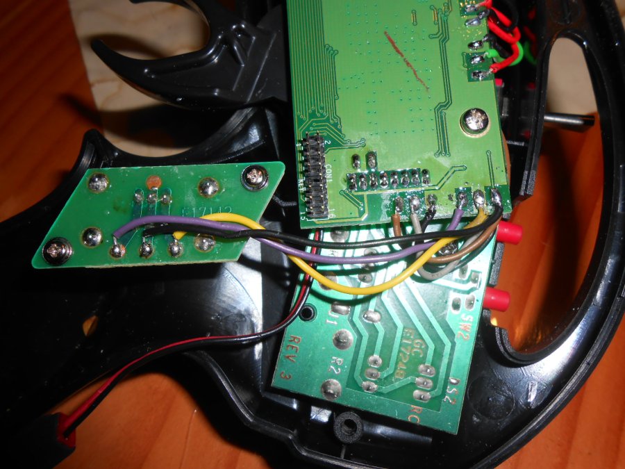

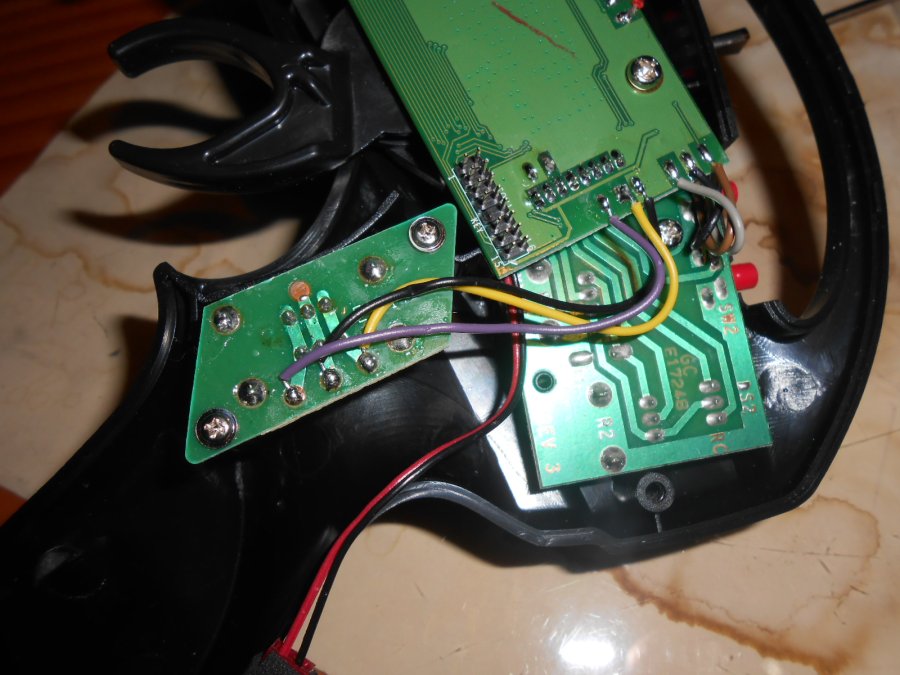

    I do it, exchange the cables and re soldering in the board and now 3 position switch (the stick on top) works on channel 3 and has on-off-on and the side switch (red one) works on channel 4 and is on/off .... the channel 5 was lost, only works to supply power for the fan ....
    soon I will put photos and some explanation
    regards
  6. #6
    RC Enthusiast
    Join Date
    Apr 2011
    Posts
    35
    hello:
    this are the pictures before and after the mod. ....
    Before - original:
    After mod:
    regards
