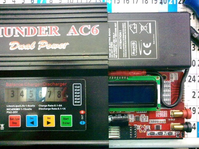

    -This is my charger... it is not a high end model, nor a cheap china one... just china normal one... the power source inside will die after 2 years of use but then you can use another quality one inside or use an external... i have this for 4 years and i charge daily stuff! You can get a good brand one like orion,hitec, whatever....
