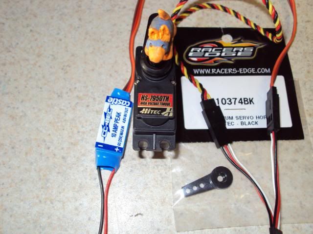

    Single servo: This one I might need some help.
    Traxxas servo Y connector: adapter (for dual-servo steering) P/N2046
    Aluminum Servo horn Hitec for Revo P/N 10374BK
    Castle BEC 10 amp P/N 010-0004-00
    specs & wiring digram:http://www.castlecreations.com/suppo...user_guide.pdf
    Hitec HS-7950TH P/N HTS37950
    "Ultra Torque" HS-7950TH is designed to operate on a two cell LiPo Pack. Featuring our high resolution "G2" second generation programmable digital circuit and our indestructible Titanium gears, The HS-7950TH has the performance and durability you've come to expect from a Hitec servo. Other features in the HS-7050TH include a 7.4v optimized coreless motor, integrated heat sink case, and a top case with two hardened steel gear pins supported by axial brass bushing.
    The HS-7950TG has been designed for the most demanding hobby applications including the largest aircraft and monster trucks. Featuring a titanic 403oz./in. of torque at 6.0 volts, while still maintaining a respectable 0.15 second transit time
    Detailed Specifications
    Motor Type: Coreless
    Bearing Type: Dual BB
    Speed: 0.15 / 0.13 sec (6.0v/7.4v) @ 60 deg.
    Torque: 403 / 486 oz./in. (6.0v/7.4v)
    Detailed Feature Descriptions
    # G2 Digital Circuit
    # Titanium Gear Train (MK first gear)
    # Ultra Performance Coreless Motor
    # Heatsink Case
    # (8) O-Rings for Water/Dust/Fuel protection
    # Dual Ball Bearing Supported Output Shaft
    This is the link from way back http://traxxas.com/forums/showthread...o-single-servo
    I believe that this servo can do 7.4 v. Post #58 This is how I am wanting to wire it up. Just not sure on cutting the Y Harness w/+&-taking out on male end. I think this method will allow you to still connect the ESC to Castle Link. That is why I am wanting to do this method. What do you think, Thanks for the help.
    Would you go flip my truck back over??

    I am trying to figure out what you need another servo
    This is why: Torque: 403 / 486 oz./in. (6.0v/7.4v)
    stock servo are 125 oz/in each total of 250 oz/in.

    oh ok, so you are using it for the steering, you are just getting the power for it from a better source. now i get it. i was trying to figure out what you might want another servo for. i thought maby you were hooking up another servo for somkind of cool option like smokescreen or an oil slick, that would be cool though. based on what i found you are incorrect, check out this link. it says never do what you are trying to do with getting power from both batteries, only get power from one
    http://www.castlecreations.com/products/ccbec.html. scroll down and see the "NEVER DO THIS"

    What you are looking at is 2/6s batt = 12s / 44.4v, The BEC has a max of 25v or 2/3s.. What they are telling you is to not run it is series. In this case (12s) that in not what I am doing.. You can't put a 6s battery in a Revo anyway.

    ok, i did see that in there example they had 2 6S batts and you are using at most 2 3S batts. just was not sure and just wanted to make sure you saw that before you did it. wouldn't a smoke screen be cool as He!! though.
    As I sent via your PM, the picture below shows how to hook a servo directly to a higher voltage BEC while allowing the ESC's BEC to power the receiver:
    http://scriptasylum.com/rc_speed/

    I've done that harness mod. I simply took out the + and - wires and soldered them together and left only the signal going back to the receiver. It really is that simple

    Radio: I went & bought a 2.4GHz Link Rx 2218x, & the three channel Link Radio model 2239. So I can run the micro servo on the trans (high ~ low).
    Step:
    1) bind the radio & Rx Page 14 & 15 in the manual
    2) Program (calibrate) ESC EVX-2 page 16 manual (set throttle end points)
    or
    3) Program (calibrate) ESC MMM Addendum sheet (set throttle end points)
    http://traxxas.com/sites/default/fil...9_090826_0.pdf
    On most Rx's the black, brown or what ever is the darkest color wire goes out. The out edge of the Rx.
    Channel one has two slots for the servo wires. In the pic there is only one pluged in because I went ahead & put on the Hitec HS7950th.
    Channel two is for the ESC.
    Channel three I am using it for the micro servo on the trans high ~ low.
    Channel four & five are for the other micro servo's, (or a glitch buster) .
