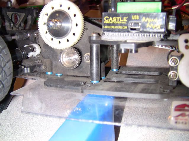

What mods did you do to your battery tray to fit larger battery packs? I got some nail polish remover for the glue. Thought I would try that first since it was convenient. Just realized last night that my motor is rubbing on the front belt. I'm sure that's another reason it was running a little slower than expected. Know of anyone that makes a 48p pinion gear that's bigger than RRPs 47 tooth? I have several bigger spurs that I know will make it fit if not. Again your help is appreciated and your written conversation is enjoyed.

I cut out the two chassis supports just behind the servo then used washers that were 3mm thick to raise the upper chassis. The battery is now held down by 2 zip ties.
The blue dots show the placement of all the washers I used to raise the chassis.

Thank you for the pictures. Did you place the washers on top of the bottom tray or on the bottom of the top tray. I hope that makes sense... Maybe it will be clearer to me when I take the car apart again. I understand that the blue dots are the placement of the screws that hold the top chassis on. Are any of the washers shown in the top picture? I realize your point with that picture was to show the removal of the braces and battery fitment, nice work. I thought about just raising the back of the top chassis by placing 2 washers in between the top chassis where it attaches to the motor plate (on top of and in front of the motor). I really like the lexan plate. You're very ingenious with these modifications. You should design the new 4tec for traxxas (looks like you already have). I'm betting your car will go 100mph or more. Do the HPI tires balloon at all with that much power? I really like mine. Thanks for the suggestions.
Sorry heres a better picture showing the battery bay and placement of some of the blue washers.
The lexan plate was more to help keep some of the dust and debris out of the gears and belts. And the hpi tires don't baloon.
Great! Thats very helpful. Did you cut your own spacers or did you buy them somewhere? Did you end up being able to use the stock screws on the bottom or did you have to get longer ones? I'm sure the lexan plate will help with aerodynamics as well especially at high speeds.
I bought them. 3mm countersunk. As for the screws some are slightly longer than stock. As for the aerodynamics it is possible the lexan sheet helps im not sure though.
