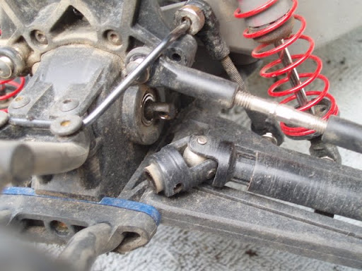

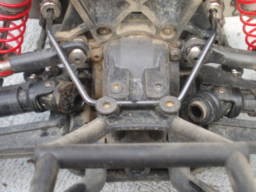

    There is some clicking noises coming from my Slash. I'm wondering if I need to put oil in the diffrential. Do you think it leaked out?
    The left side has oil coming out at the driveshaft, the right side is fine.
    Here are a couple pictures of the left & right side.
    Left side
    Right side
    Do you think that might be the problem? I checked the pinion & spur gear. Is there a way to stop it from leaking out?

    i would use 10k diff lube, and get a new bearing for that side of the diff. the reason for most leaks is caused by bearing malfunction.

    easy fix the problem is your bearings need cleaning clean out the diff and replace with some 5 to 10k diff silicon oil. the bearing need to be cleaned and reoiled with some thin motor oil nonsynthetic. if you use syn make sure you use the same kind everytime. dont try using WD40 its too thin to lub them up and after using it makes the oil you put on the bearings really silk and not want to bind to it. thats probely not the correct wording to use but it makes sence to me. the electrica motor cleaner you can buy to clean off electrical parts works good for cleaning since it dries fast and with no residue. the blue sides on the bearings can be pulled off by using an exacto knife by sliding it on the outer edge of the blue section and slightly tilting it and pulling up to expose the bearings. also dont try and fill the bearing up with alot of oil. place several drops and then spin the bearings so to lube them all up before putting it back together. if too much oil is used it can cause excess dust build up and cause the same problem again. also the stock grease in the diff case cover should be cleaned off and new grease added so to get all the grit and grim out of the gears. i think that should cover everything. oh a note to add i use 5k on the rear and it works great for small tracks with alot of turns the thinner lube helps to even out the torque on the rear when cornering. alot of people i talk to run 5 to 7k on rear and 10 to 15k on front. I dont know about the center diff yet since i havent gotten one yet but its on the top of my list.

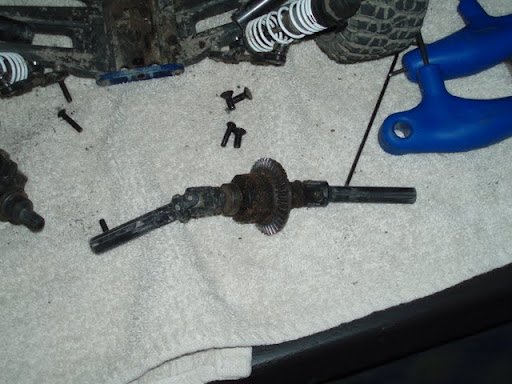

    Well, it's been a while but I found the problem...................
    After I cleaned it out, put it back together & drove it. The click was gone!
    I think it was a combination dirt in the diff housing & a partly stripped spur gear.
    Since then there has hardly been any problems except if I hit really hard in the rear the click comes back then if I land hard again it goes away.
