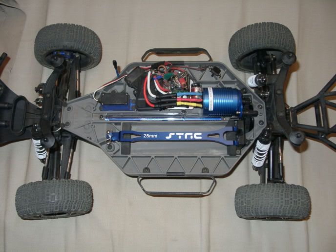

    I got my Slash PE 4x4 a few weeks ago and have been getting it dialed for the local track. Tried the stock Velineon system on 2s and 3s lipo, and I found that on 2s the truck is very fast and the 2s gives a good balance between power and weight. The 3s was more powerful, but harder to control and added extra weight, which impacted handling. That being said, now I am going to try a bigger motor, a TeknoNeu 1509/1.5Y which is a 2400kv motor with a can that is bigger than a standard 540 but smaller than what would be used in an 1/8 scale buggy (a 1512 or 1515 sized motor). A larger motor on more voltage should provide plenty of power and run very cool. I also have a Castle Creations CS-5700 motor and a Tekno Neu 1512 2650kv motor I want to try out as well. The TeknoNeu 1509 setup weights 5oz more than the stock Velineon system.

    As I mentioned the stock system works fine on 2s, but runs a little hot on 3s. Yes I could lower the gearing to get cooler temps, but I would be at a disadvantage against the other trucks I race with (open class, Slash 4x4's on 3s, Jammins and Ofna's). I am a racer and to be competitive I have to gear up to maintain the same speed, and as I mentioned, stock motor on 2s works fine (fast enough, runs cool), but with a larger Neu motor with less kv and more volts I can gear higher for more speed and it still runs cool. I normally race 1/8 brushless buggies/truggies and this setup works well. Since I have the motors available I don't see why it would hurt to run different motor/battery combo's to see how they perform. I currently run a Neu 1509 in my Jammin and it runs great, just thought pass on my observations for on how different setups work in the Slash.
    Neu 1509 motor compared to a Castle Creations 5700kv motor. Neu is bigger, has more torque and runs much cooler at the same speed.
