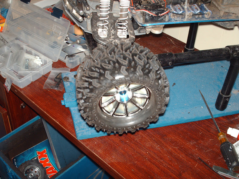

    Dijr50, heres a quick update of the zombie maxx tires that I bought a few months back... I decided to cut the foams with the forty five degree angle because I fount that the foams seated themselves better that way.
    Go ahead and duct tape the tires too. The Zombie Maxx tires have a ton of grip and by using duct tape, all you are doing is making sure that the tires dont expand under high rpms. It may take a few runs for the tires to set themselves up. I found that during the first tank, the wheels had a bit of a wobble to them, but after the second tank the wobble was gone and they ride nice and smooth now.

    Thanks, Wildjones! I cut the foams, and tape the insides. Now, I am putting them on and gluing them. These tires seem to be directional...what way do you have them pointing? This is how I think they should go...any objections?

    That is how I set them up, and wow do they hook up good!

    I agree the Zombie maxx tires are awesome, I cut the foams and taped the tires and the difference between them and stock is amazing. djjr50 that is the direction I have mine facing as well.

    Nitronaught, what is the purpose of drilling the two holes on the inside of the rim? Just curious...
    It allows the foams to dry if you some how manage to get water inside as well as allow the tires to "breathe." If you did not drill the holes and you glued the tire and later tried to push on the rubber you would face resistance (albeit a small amount) from the air within the tire. That last sentence I am not too sure about, thats what the guy at my LHS told us back when we first got our trucks...
    The purpose is to let the tire breath. The amount of rpms those wheels are spinning at and the certrifical force makes the tire want to stretch/balloon. IF you do not let the tire breathe than the centrifical force can cause the tire to literally implode by the vaccume created inside the tire when the tire is ballooned or it can cause the ca glue to give way but something will have to give. It also allows your tires to act as more of a shock absorber when landing off a jump, or a rough surface. Get's rid of the bouncy bouncy bouncy from the tire....
    As far as removing the glue from your fingers? Nail polish remover, goof off, (both also known as acetone) does the job nicely, also if you have surgeons gloves on before you glue it works pretty well too. If you are careful, use the glue at room temperature and go slowly you shouldn't get any on your fingers. Note: nail polish remover, goof off and acetone will remove any chrome finish to the wheels, so don't use them on your rims if they are chromed or have a finish of any kind.
    djjr50, the newer foams from Proline are molded so if you are using molded foams no cutting is needed. The cutting of the foams is to make a better fit. Your tires are not a 90 degree angle on the edges, but the foams in th package are, you are just making them fit correctly. The duct tape on the inside is not that stiff, but has cords in them. So it will allow the tire to keep pretty much the same amount of contact to the ground so there is no traction loss. The tape acts like the belts inside 1:1 car tires have, they help the tire retain it's shape at high rpm's.
    Hope this helps. And thanks for all the compliments.... I have gotten a lot of good help on this forum. Just my way of spreading the wealth around.

    Q: I notice you do not call out making holes in the tires themselves (presumably to let dirt out that may get in), are they already in your tires or do you not feel that's a good practice? Will holes in the tread area really let dirt out?
    I would think holes in the actual tires would make them a lot more prone to tearing.
    Some people put holes in their tires, but that's not as much for the breathing as it is to let out water. For all those who get their TMAXX's wet enough to get water in them.
    My TMAXX is not waterproofed and I would do that if I was doing heavy mudding. Otherwise no need to be drilling holes in the tires. Also if you do drill holes in the tires I highly recommend doing it before mounting them. Drilling them when mounted risks the drill bit of catching on the foams on the inside and pulling them or twisting the foams making them uneven and then you will have problems getting them nice and round again.
    Dirt does not get in the tires unless there is a way for the dirt to get in them, same for the water, you would have to get the tires submerged to get the water in, if you want to do that I've seen it done. I have come to the point where the nibs of my Crimefighters MTRs or my Holeshots MTR's (now they wear out quick those Holeshots) I've boiled the old ones off and I did not find any accumulation of dirt in there, so I'm happy with the method I use.
